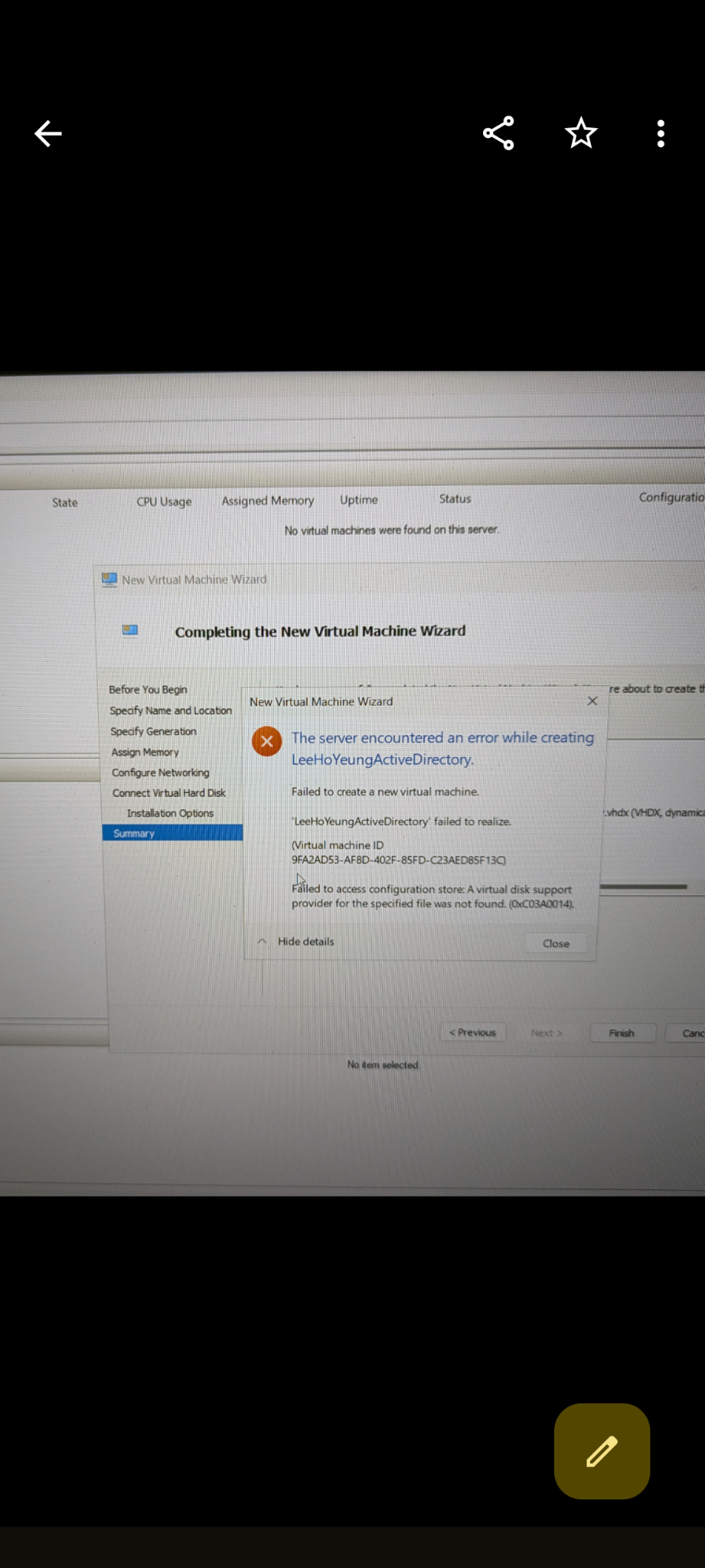

Hyper-V generation 2 failed to realised with error 0xC03A0014
Ho Yeung, Lee 1 Reputation point
2025-04-20T03:24:32.8766667+00:00
after install data centre and then hardening group policy,
failed to access configuration store
virtual disk support provider for specified file was not found
another things is network adapter folder empty
then I change device guard policy back to not configured and gpupdate /force
same error.
and network adapter folder empty no adapter
Latitude 7650 - windows server 2025 data center OEI
UTF-81000005479
UTF-81000005477
Windows Server 2022

    If you receive any error message during the procedure above, please attach a screenshot of the error message to help to identify what is causing the problem
