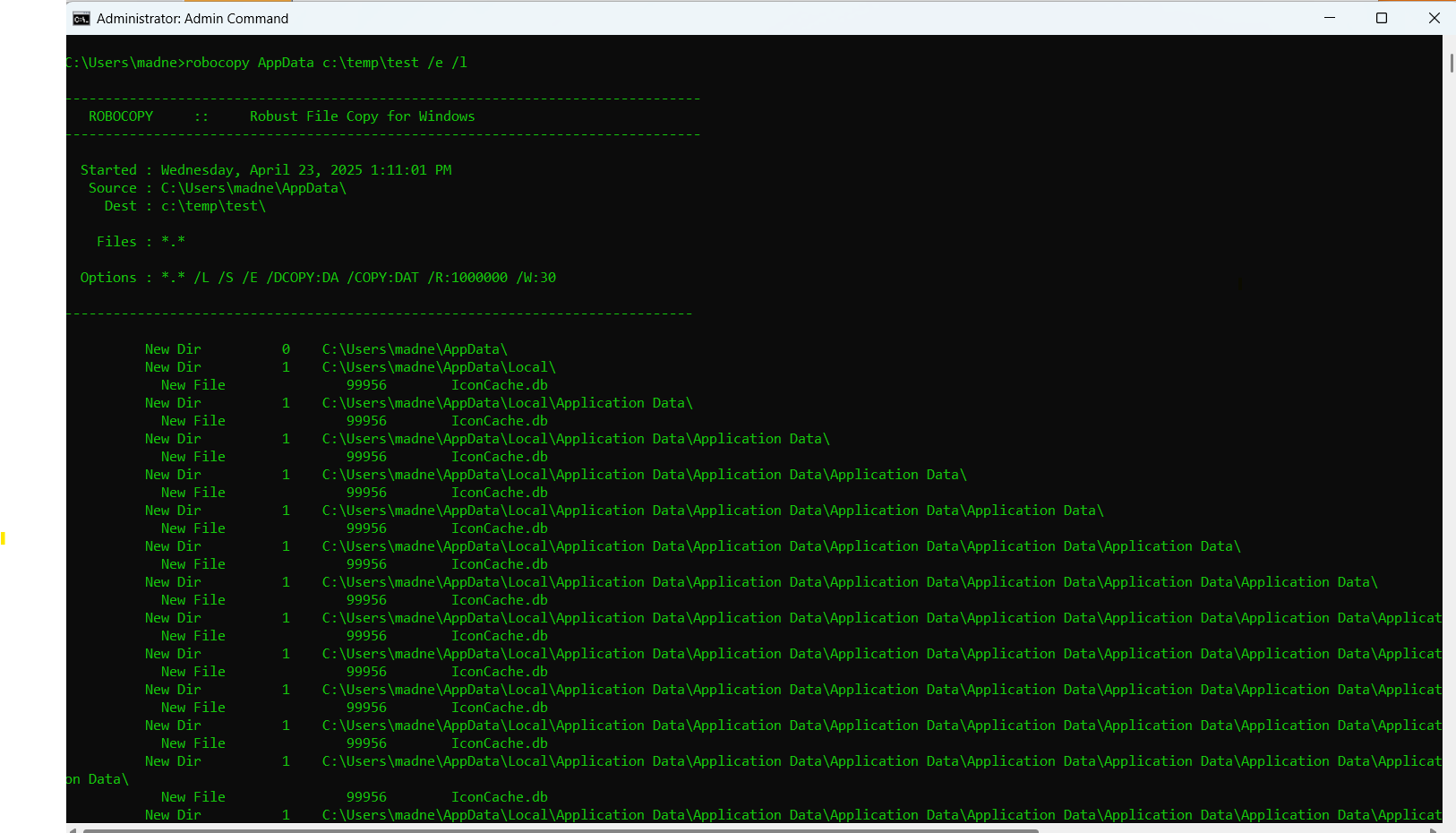

  3. MotoX80 35,726 Reputation points
    2025-04-22T13:35:23.1566667+00:00
    I don't think that Remove-Item has an option to deal with symbolic links. Get-ChildItem has the -FollowSymlink switch to override its default. I suspect that you are running into the recursive "application data" feature.
    https://superuser.com/questions/1559693/robocopy-loops-nests-application-data-29-times-when-copying-application-data
    Remove-Item would need the equivalent of robocopy's /XJ or /XJD switches.
    From a command prompt you can run this to see what links are defined.
    dir D:\Backup\PROFILES\Personal\User1\Desktop\ /a /s | findstr "<JUNCTION>"
    I have not tested this, but I would think that you should be able to use Get-Childitem as a workaround.
    Get-ChildItem Path D:\Backup\PROFILES\Personal\User1\Desktop\ -Recurse | Remove-Item -Force

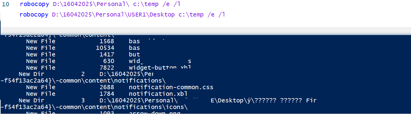

  4. Hram Admin 120 Reputation points
    2025-04-24T08:24:22.17+00:00
    MotoX80, thank you so much for this - https://superuser.com/questions/1559693/robocopy-loops-nests-application-data-29-times-when-copying-application-data - I didn't know it!
    Regarding the problem with Application Data: I'm trying to delete the folders that do NOT contain Application Data (they are the folders created by another backup which does not copy Application Data) so I think it's not the case:01
    dir D:\16042025\Personal\User1\Desktop\ /a /s | findstr "<JUNCTION>"
    dir D:\16042025\Personal\User1\ /a /s | findstr "<JUNCTION>"
    • both returns nothing.
    Here are my tests:
    02
    -robocopy does list each object as excpected...
    04
    ...but Remove-Item seems not :(
