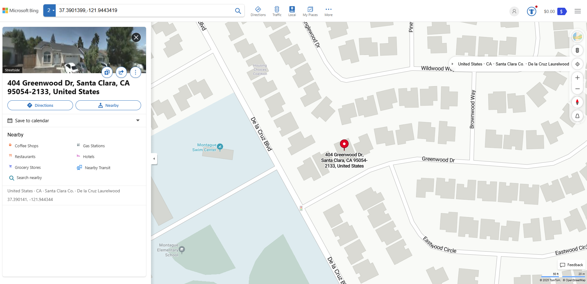

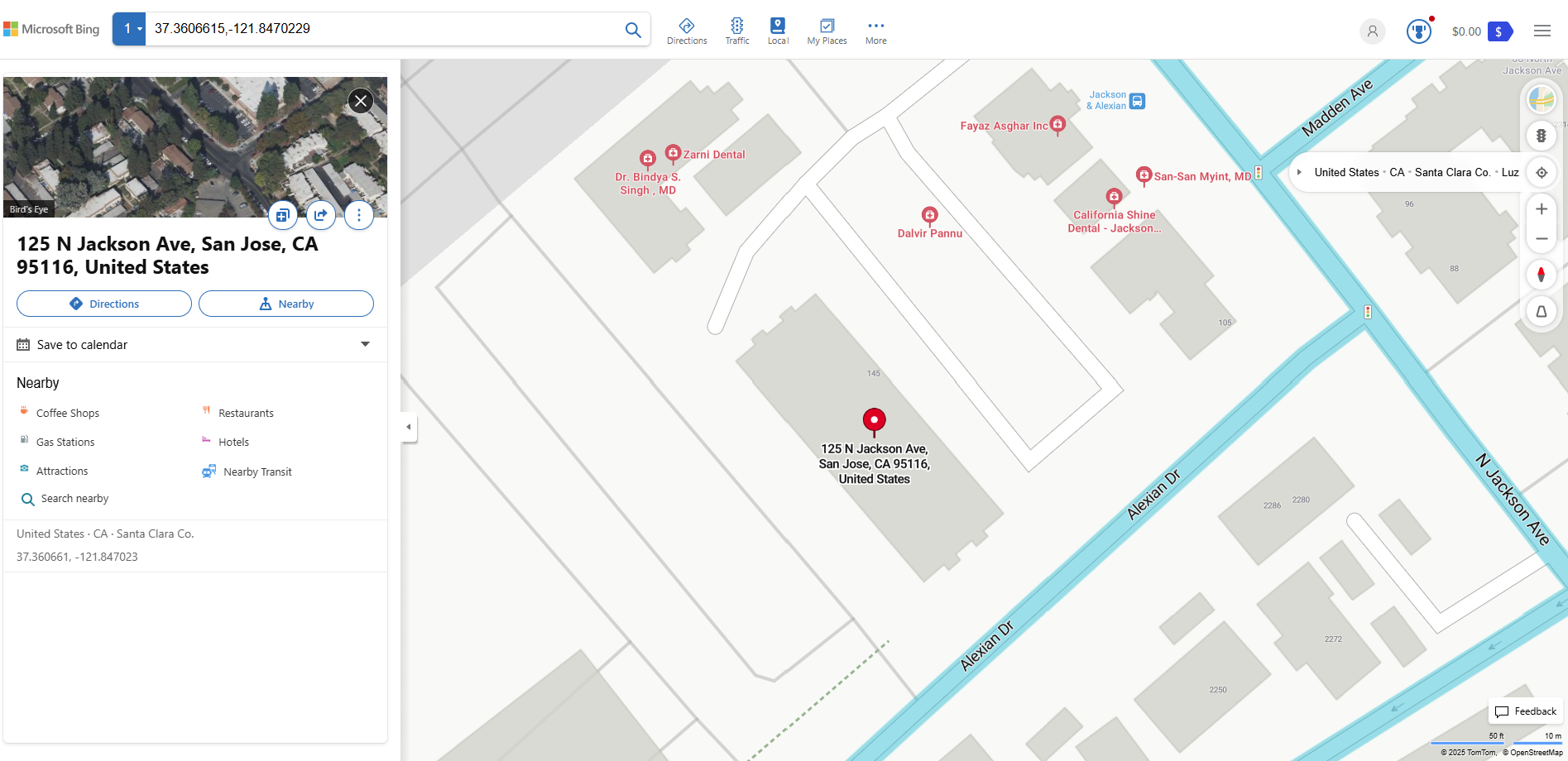

Hello, I am trying to get the distance between two coordinates and Azure Maps is failing and returning a NO_ROUTE_FOUND error. Here is API request that I am using that is failing:
https://atlas.microsoft.com/route/directions/json?subscription-key=<redacted>&api-version=1.0&query=37.3901399,-121.9443419:37.3606615,-121.8470229&routeType=fastest&traffic=false
Would you be able to update the database the Azure Maps uses to get these addresses working? Both locations seem to be legitimate buildings.

    Looks like you are using the old v1 routing service. Try the newer service: https://learn.microsoft.com/en-us/rest/api/maps/route?view=rest-maps-2025-01-01
    The older service used TomTom data and services directly behind the scenes, and there where the odd location where a route couldn't be calculated.
    The newer service uses the same data and backend as Bing Maps (bing.com/maps) which has a lot more data and improved logic.
    Note that the API interface and response format of the new version is very different from the v1 service. Also, the new service only accepts post requests. The main reason for this is that there are a lot more options available and it is not possible to use half the options before a GET URL would be too long and cause issues in some system.
