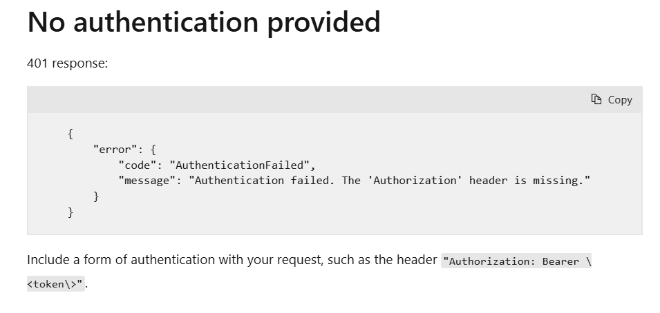

I have created an automated task in Azure to power down a Windows 2019 Datacenter edition o/s server but it failed with the following error message:
{ "error": { "code": "AuthenticationFailed", "message": "Authentication failed. The 'Authorization' header is missing." }}
Does anyone know what might be causing the issue?

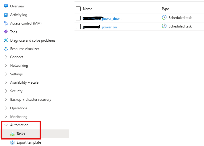

    Thank you for confirming. You don't require a script, these scheduled tasks utilize Azure Logic Apps or Azure Automation to execute the action. This means that authentication is still necessary, likely occurring through your Azure account credentials or a service principal established during the task setup.
    Check the role assignments in Azure portal: VM > Access control (IAM) > Role assignments
    See that you have Contributor role or Virtual Machine Contributor role.
    Recreate the Task with Proper Permissions: Delete the existing task from the VM > Automation > Tasks blade.
    Recreate the task using your own account, which is the recommended way, or A service account with Owner or Contributor rights. Ensure the identity creating the task has at least the Virtual Machine Contributor role.
    Check Microsoft.Compute Resource provider: Go to Subscriptions → Your subscription → Resource providers. Ensure Microsoft.Compute is registered. If not, click "Register"
