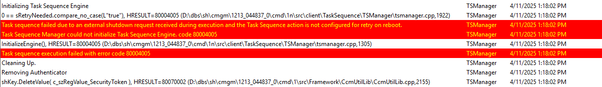

SMSTS.log reports an unexpected reboot caused the task sequence to stop

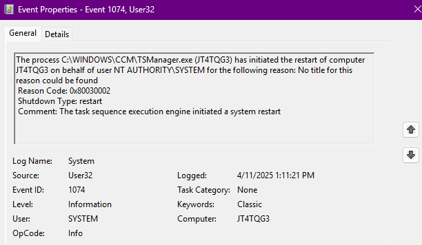

The windows system event log shows when the TS rebooted the system for the update
and then shows trustedinstaller rebooted it a few minutes later for the update.
The last entry in smsts.log when the TS rebooted the PC was as 1:11:20p and the next entry was at 1:17:49p so there was no TS or Config Manager activity where a reboot would have interrupted it and I do not have any reboot steps in the TS around the time of the update. I would expect the TS to be aware of all reboots Windows is doing prior to when the TS starts running again but it apparently does not.
Does anyone have any thoughts how to prevent this from occurring? One of the messages in smsts.log at the failure says "Task Sequence action is not configured for retry on reboot." I looked into how to set it to retry and I found the SMSTSRetryRequested and SMSTSRebootRequested variables in the documentation at https://learn.microsoft.com/en-us/intune/configmgr/osd/understand/task-sequence-variables#SMSTSRebootRequested but both look like they do the same as the Restart Computer TS step and not actually retry the TS if it failed.
