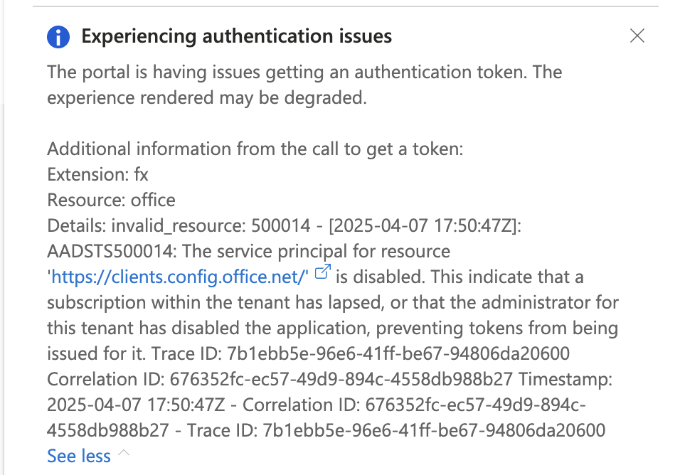

RBAC users who have access to our CosmosDB instance are getting the following pop-up on the Azure portal Data Explorer. I am an owner, and I also see the error. It seems to be irrelevant, as all access to configurations and data based on role is working. However, the pop-up remains until dismissed. When we use https://cosmos.azure.com/, we do not see any authentication-related pop-ups. Any ideas what might cause this? This tenant does not use Office365. Thanks.
SS 2025-04-07 at 1.51.19 PM

    I sincerely apologize for the inconvenience caused. We understand how important it is for services to function seamlessly, and I truly regret any disruption you may have experienced.
    It appears the issue has been resolved now, and you're no longer facing difficulties. After reviewing, we suspect the root cause may have been related to a temporary backend issue.
    To help ensure ongoing stability, please also verify the following on your end:
    Verify Subscription Status: Ensure the Azure subscription tied to your Cosmos DB account is active.
    • Sign in to the Azure portal as a Global Administrator or Subscription Owner.
      • Navigate to Subscriptions in the Azure portal.
      • Check the status of the subscription associated with your Cosmos DB account. If it’s expired or disabled, renew or reactivate it.
    Check if the Service Principal is Disabled: Confirm whether the service principal for https://clients.config.office.net/ is disabled and re-enable it if necessary.
    • Sign in to the Azure portal as a Global Administrator.
    • Navigate to Azure Active Directory > Enterprise applications. In the Application type filter, select All Applications.
    • Search for the application associated with https://clients.config.office.net/ this URL or its display name.
    • If found, check the Properties tab to see if Enabled for users to sign-in is set to No. If so, set it to Yes and save the changes.
    I truly appreciate your patience and understanding. Please reach out if you need further assistance
