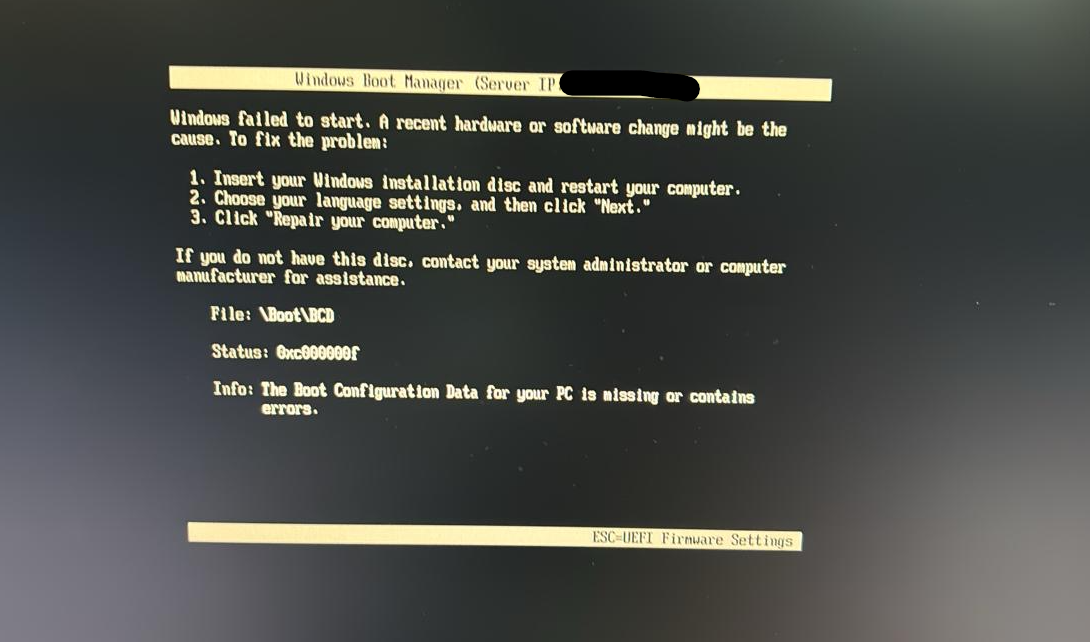

Dear Team,
We have configured SCCM PXE on one of our DP and made the changes into the DHCP for port 66 and 67.
This is the first time we are going to build a PC over the network. While attempting to test the device, we are getting the below error regarding the BCD.
The device is reaching out to our SCCM DP as you can see Server IP in the screenshot however its not moving from this step.
Is it due to the port blockage from SCCM to client or any other configuration needs to be in place ?
Please share your expert advice here.

  1. Simon Ren-MSFT 40,406 Reputation points Microsoft External Staff
    2025-03-24T02:27:09.8733333+00:00
    Hope everything is going well.
    1,Please check the smspxe.log on the server to see if there is any further information.
    2.Check if all components like Boot images, OS-Images, Task-Sequences and Announcements are published to all distribution points in the Content Library.
    3.Update the Network Driver to your Boot images. Then redistributed both updated boot images (x86 and x64) to the PXE-enabled DP and check if the redistribution succeeded.
