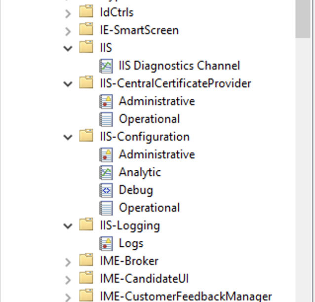

Can't see IIS-FTP logs in event viewer:
Note: Tested on Windows Server 2012, 2019, and 2022.
I heard that we can find the log coming from the IIS-FTP source with the event id 13, in the event viewer. This event id indicates failed logon attempt to an FTP server (running with IIS 10 and logging is enabled). Also, verified IIS-FTP is installed (FTP Extensibility, FTP Server, FTP Service) I'm able to see the IIS-Configuration, IIS and IIS-logging folder under Application and service logs -> Microsoft -> Windows but not able to get the IIS-FTP
How can i get the logs for IIS-FTP in event viewer?Screenshot 2025-03-19 at 12.42.30 PM

    You're absolutely right that Event ID 13 is associated with FTP logon failures in IIS. However, it's important to clarify that IIS FTP does not log these events to Event Viewer by default, even though the event ID exists. Instead, FTP activity—including failed logins—is primarily recorded in FTP log files, not in the Windows Event Log.
    FTP logs are stored in W3C format at:
    C:\inetpub\logs\LogFiles\FTPSVC<siteID>\
    It should look like this:
    Event Viewer does not include a dedicated “IIS-FTP” log folder. Even though Event ID 13 exists, it is not automatically triggered by FTP failures unless you implement a custom logging solution. This design is intentional to avoid flooding the Event Log with application-specific entries.
    If you want to see Event ID 13 in Event Viewer, you can use a PowerShell script to scan your FTP log files and manually write failed login attempts to the Event Log.

    There is no such a thing. If you are trying to monitor activities of your IIS server, then unfortunately you need to read the separate log files. This applies to many Microsoft or third party products, as no one should flood the event log for application specific log entries.
    I'm sure you've seen a similar solution below, using LogParsesr to convert logs to evtx format, which only works theoretically, but after investigation LogParser 2.2 supports reading evtx files and not exporting.
    So you should ignore this method.
