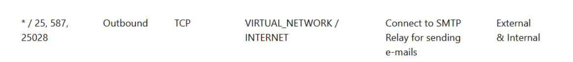

Could you please try the workaround below and let us know if it resolves your issue? In the meantime, we will also connect with our internal team on this issue.
Please use the following ports to disable the email notification: 25, 587, 25028. Refer to the screenshot and the document below for guidance.

2025-03-20T14:23:23.26+00:00 @Loknathsatyasaivarma Mahali I did try the workaround, however notification emails are still being send. I tried with the following two NSG rules:
{ name: 'BlockSMTPFromApiManagement' properties: { protocol: 'Tcp' sourcePortRange: '*' destinationPortRange: '' sourceAddressPrefix: subNets.apim.prefix destinationAddressPrefix: '*' access: 'Deny' priority: 443 direction: 'Outbound' sourcePortRanges: [] destinationPortRanges: [ '25' '465' '587' '25028' ] sourceAddressPrefixes: [] destinationAddressPrefixes: [] } }
{ name: 'BlockSMTPFromApiManagement' properties: { protocol: 'Tcp' sourcePortRange: '*' destinationPortRange: '' sourceAddressPrefix: 'ApiManagement' destinationAddressPrefix: '*' access: 'Deny' priority: 443 direction: 'Outbound' sourcePortRanges: [] destinationPortRanges: [ '25' '465' '587' '25028' ] sourceAddressPrefixes: [] destinationAddressPrefixes: [] } }
I do not want to block all SMTP traffic from the VNET, but only originating from APIM.
