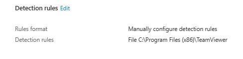

  • I have a Win32 application deployed via InTune to x26 Windows 11 devices
  • All devices (same make & model) have reported back as Installed apart from one of them
  • One device is reporting "The application was not detected after the installation was completed successfully (0x87D1041C)"
  • On checking the device manually I can see the application has installed, and if I look for the file I am using for detection it is present and correct
Given all the other devices are detecting the app ok I think the issue is with the device, not the InTune app detection rules.
I have uninstalled and let Intune reinstall the app again but the same issue occures. The normal logs aren't showing much other than detection failed...
Is there a way to repair Intune on Windows 11 devices or what else would people sugggest please?

  2. Daniel Le Maitre 0 Reputation points
    2025-01-30T14:30:32.0333333+00:00
    Hello
    I have resolved this issue as follows:
    • Retired the application that had the one device reporting detection issues dispite all other being ok and the app is installed and the file attributes being detected are on the device
    • Re-created the app from scratch with different detection rules in place (checking specific folder exhists) and tested then re deployed it.
    Not ideal but I need to move on from this issue, plenty other other things to be doing :-)
