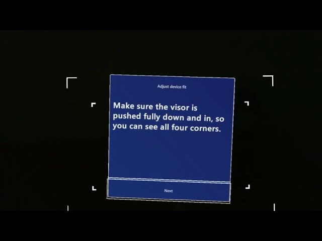

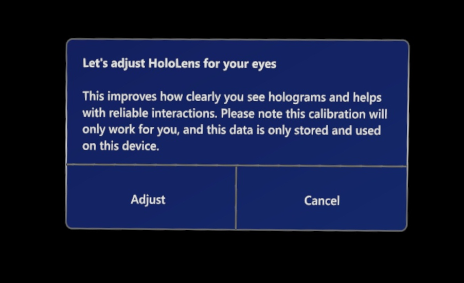

I am developing an application for Hololens 2 controlled by eye-tracking. I have used the "eye calibration checker" script from one of the examples to launch the calibration routine when a new user wears the headset.
In order to complete the calibration, the user has to press a button, two times, with their hand. Since the targets of my solution may not be able to neither move their arms nor speak while using the app, I would like to know whether it is possible in any way to change these steps. As an example, by replacing the confirmation through button press with a timer.

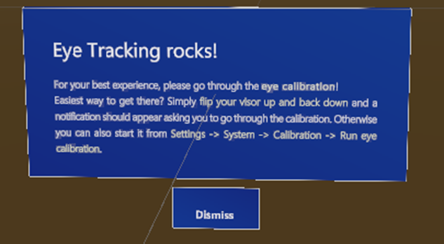

    This “eye tracking rocks!” dialog can be removed by modifying the EyecalibrationChecker.cs script.User's image

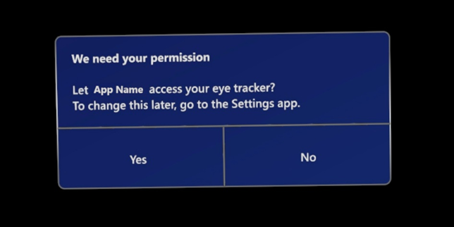

    The following permissions dialog that the user will be prompted with is from the system and cannot be removed by modifying the EyecalibrationChecker.cs  scriptUser's image
