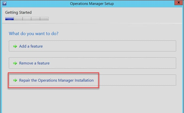

    Please attempt to repair the Operations Manager installation by rerunning the Operations Manager Setup wizard.
