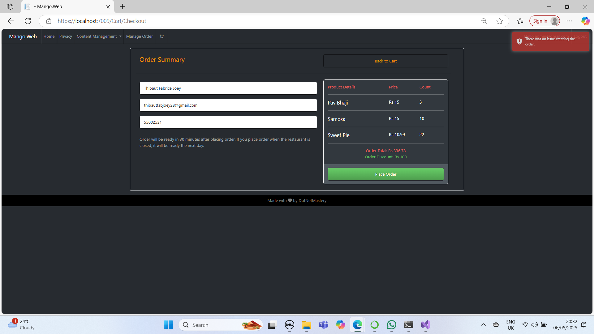

Thanks for the help. However, My stripe is not loading. Any help. There is an error: Object not set to an instance of an object.
Screenshot (460)
Github Link:https://github.com/Thibaut501/Mango
Awaiting your reply,
Best Regards,
Fabrice

  2. Thibaut Fabrice 20 Reputation points
    2025-05-06T16:34:32.2733333+00:00
    please help remove this error.
    Thanks,
    Fabrice
    Github link:https://github.com/Thibaut501/Mango
    remove error from screenshot.
    The Stripe is not loading.
    Any help Awaiting urgent reply,
    Screenshot (940)
  3. Thibaut Fabrice 20 Reputation points
    2025-05-20T18:35:28.84+00:00
    Can you reply to me. Its urgent.
    Thanks,
    Still stuck.
    Github link:Thibaut501/mango
    Regards,
    Fabrice
