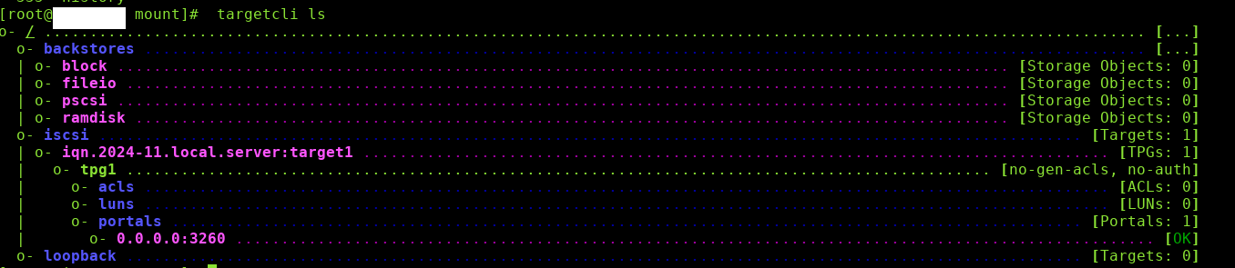

Solution: Go into system delete all of the targetcli/iscsi entries i had made, save config.
targetcli /iscsi delete targetname targetcli save
targetcli ls
located some of the old python scripts- ran them with the 'clean' option. rebooted. explicitly stopped and started the the service 'systemctl stop target.service' & 'systemctl start target.service'. Confirmed the deletion was still there 'targetcli ls'
Ran a download script and it magically worked.
Random guess - the server was holding on to an older recovery and the steps above cleared something.

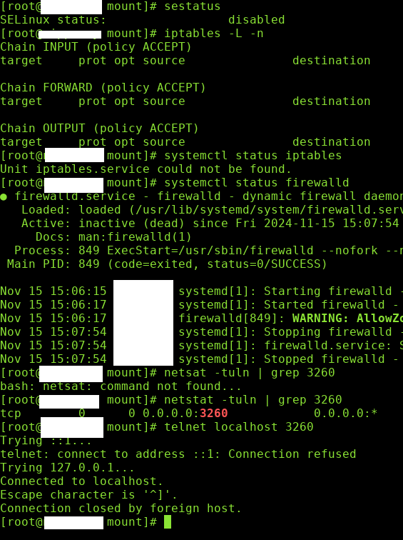

    • Since the error message suggests that port 3260 may already be in use, you can check for any processes that might be using this port:
       *sudo netstat -tuln | grep 3260*
    • Even though you've turned off the firewall and SELinux, it's worth double-checking that there are no lingering rules that could be affecting the connection.
    • Use the following command to check for any active firewall rules: sudo iptables -L -n
    • Ensure that SELinux is indeed disabled by running: sestatus

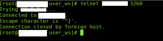

    • You can test connectivity to the iSCSI target using telnet or nc (netcat) to see if you can reach the target on port 3260:
       *telnet <IP_ADDRESS_OF_ISCSI_TARGET> 3260*

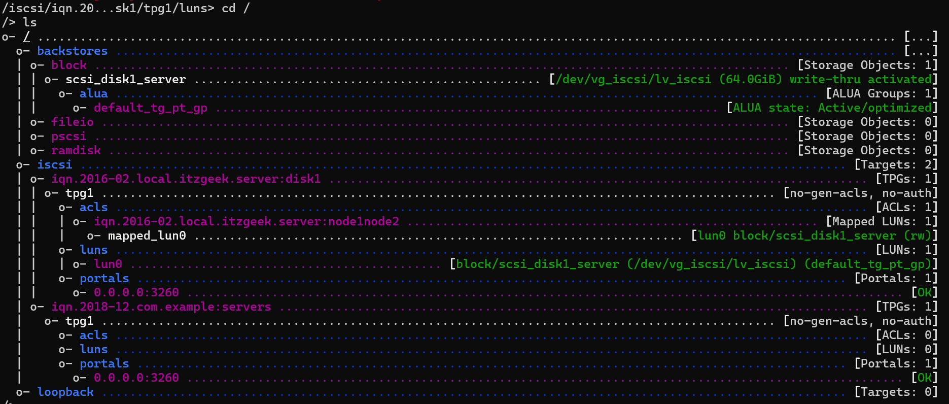

    Thank you for your patience. In addition to @Mounika Reddy Anumandla , I reproduced the same scenario in my tenant, and I was able to confirm that my connection was successful. I will clearly guide you through the steps that you can follow to resolve the issue
    Create backing storage device:
    Before we start working on our iSCSI target, we need a backend storage and create partition.
    Physical Volume: sudo pvcreate /dev/sdb1
    Volume group: vgcreate vg_iscsi /dev/sdb1
    Logical Volume: sudo lvcreate -l 100%FREE -n lv_iscsi vg_iscsi
    Install targetcli rpm: sudo yum install targetcli -y

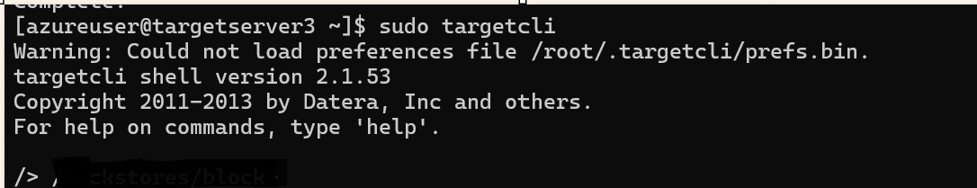

    Managing iSCSI targets with targetcli: sudo targetcli
    Now use an existing logical volume (/dev/vg_iscsi/lv_iscsi) as a block-type backing store for storage object scsi_disk1_server.

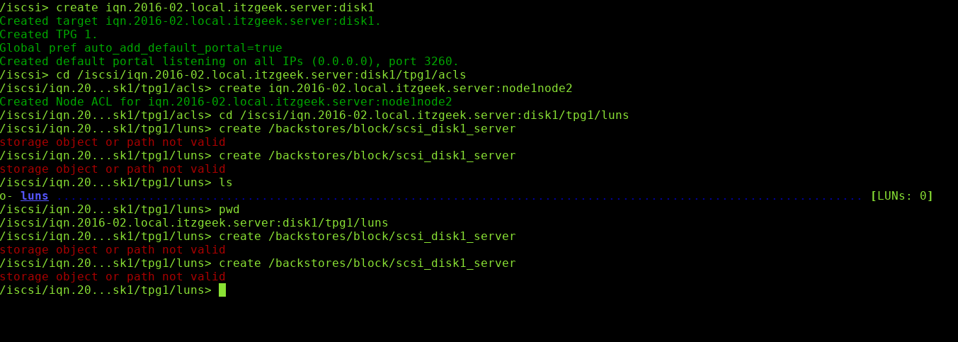

    /backstores/block> create scsi_disk1_server /dev/vg_iscsi/lv_iscsiUser's image Creating iSCSI targets: cd /iscsi

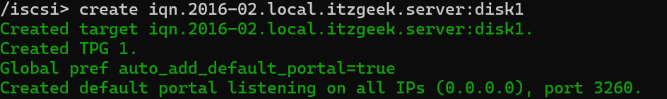

    User's image we will now create an iSCSI target: create wwn=iqn.2018-12.com.example:servers.
    I am taking on my actions: create iqn.2016-02.local.itzgeek.server:disk1
    Adding ACLs:

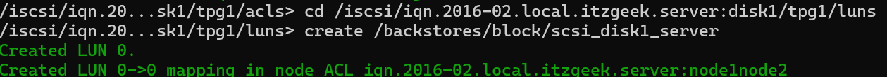

    Adding LUNs to the iSCSI target:
    Verify the target server configuration and saveconfig and exit.

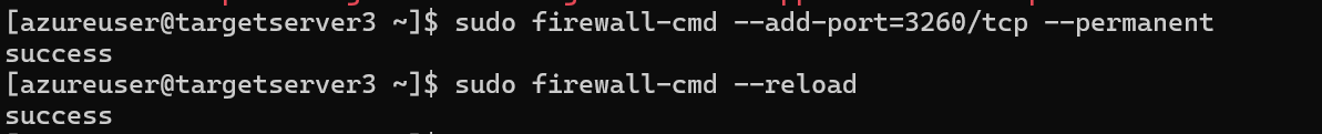

    Update Firewall: User's image
    Start and enable target service:
    Setting Up the iSCSI Initiator in target server: sudo yum -y install iscsi-initiator-utils

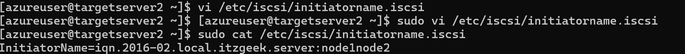

    Setting the iSCSI Initiatorname: vi /etc/iscsi/initiatorname.iscsi -update the file with the ACL name we used on the iSCSI target
    Discover the LUNs: sudo iscsiadm --mode discovery --type sendtargets --portal 10.0.0.6 --discover 10.0.0.6:3260,1 iqn.2016-02.local.itzgeek.server:disk1
    After the discovery below database is updated:
    sudo ls -l /var/lib/iscsi/nodes
    sudo ls -l /var/lib/iscsi/send_targets/10.0.0.6,3260/
    Making the connection: sudo iscsiadm --mode node --targetname iqn.2016 02.local.itzgeek.server:disk1 --loginUser's image
    If you have any further queries, do let us know.
