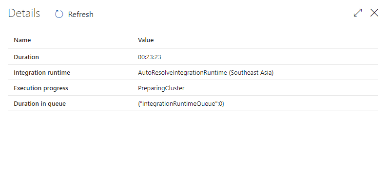

I am getting the issue to creating the On Demand HDInsights in Azure Data Factory. The status is stuck at "PreparingCluster".

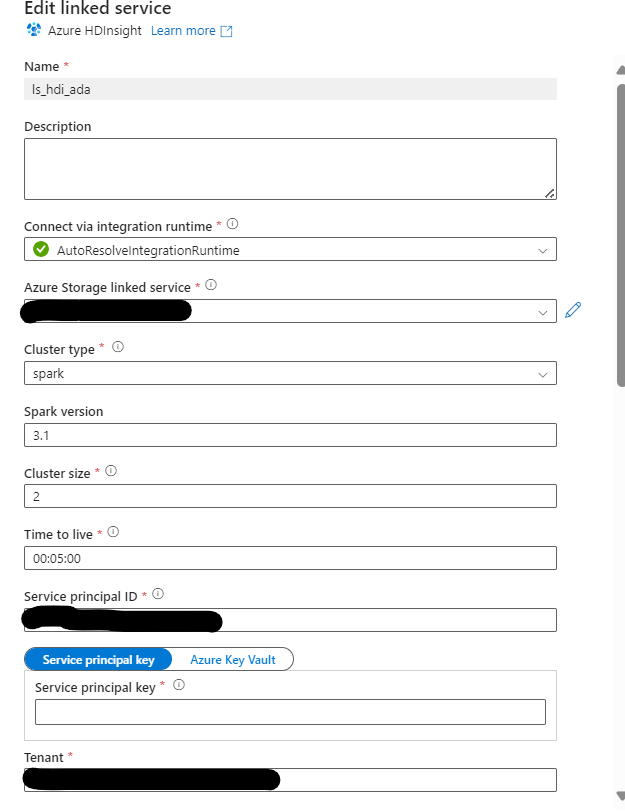

Here's my LinkedService configuration.
OS type : Linux
Azure HDInsight
Azure Data Factory

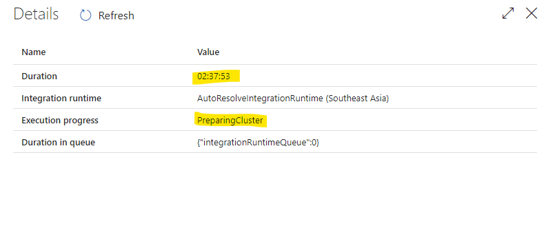

2024-11-13T06:05:32.6933333+00:00 Hi,
The status is still the same even I had leave it for more than 2 hours.
Is there any where I can check at which stage the provisioning have issues?

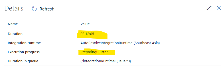

2024-11-13T06:38:57.5366667+00:00 Hi,
It's stuck at the progress "PreparingCluster" after 3 hours.
Is there any where I can check which stage actually have issues?

I have deleted and recreated the linked service for many times and same thing happened.
If not mistaken, I cannot create the cluster because it's supposed to be auto created when I execute my task.

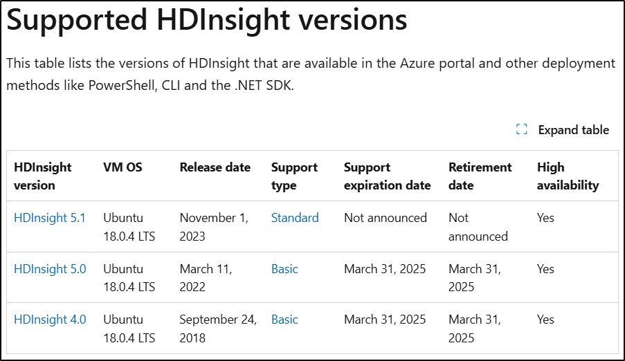

If the issue still persists, please try to upgrade the HDInsight version to the latest one in case if you are using an older version.
For details, please refer: Supported HDInsight versions.

2024-11-20T07:19:36.5433333+00:00 My issue is referring to the ON DEMAND HDInsights which I try to provision using the linked service. Are the recommendation above referring to the same or to the HDInsights clusters created in Azure Portal ?
FYI, I have no issue on creating the HDInsights from Azure Portal but the issue is with the ADF ON DEMAND HDInsights.
Hope this clarify the confusion
