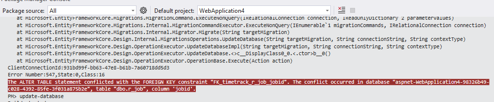

    Based on the table (timetrack and r_job) definition, do you mean the jobid column in timetrack might contain value not in the jobid column in r_job table? If that is the case, when you set the foreign key, it will cause the foreign key constraint error.
    So before setting the foreign key, you can query to check the records in timetrack that are causing the conflict, and then handle them:
    SELECT *
    FROM timetrack
    WHERE jobid NOT IN (SELECT jobid FROM r_job);
    Then, you can refer to the following steps to configure foreign key using EF core methods:

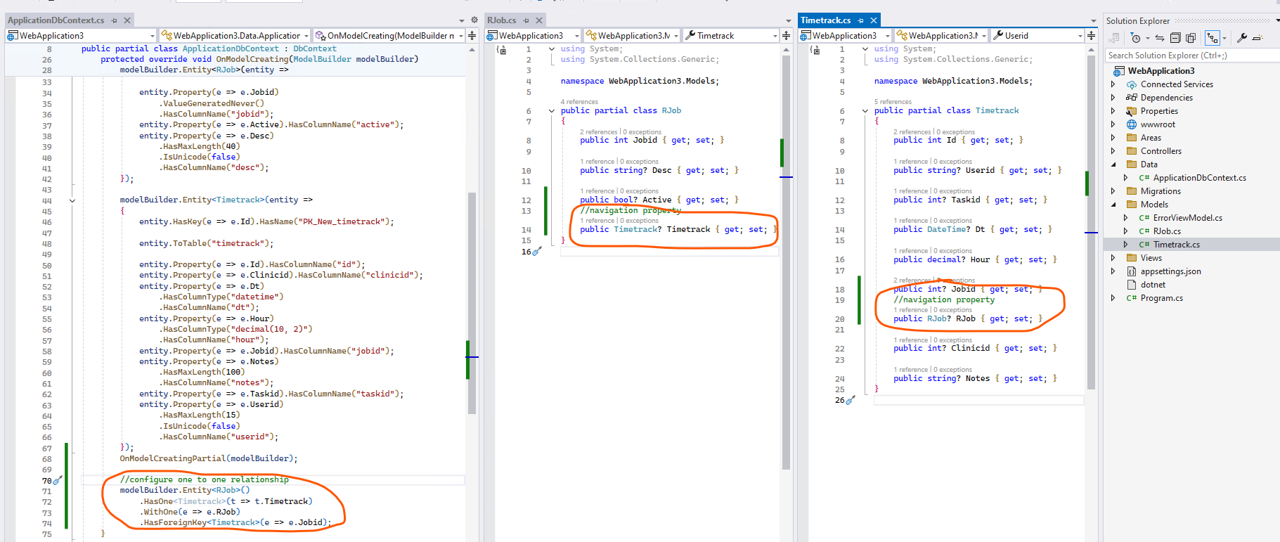

    User's image 3.Then in the RJob, Timetrack and ApplicationDbContext class, you can add the navigation property and configure relationship and add the foreign key:
    4.In the Package Manger Console, run the add-migration addonetooneforeignkey command, in the migration file, change the content as below:

    5.After that, running the update-database command in the Package Manger Console to update the database.
    6.After refresh the database from SSMS, you can see jobid column in the timetrack already is the foreign key.
    In my above sample, I configure them with One-to-one relationships, you can also configure other relationships for them, refer to Introduction to relationships.
