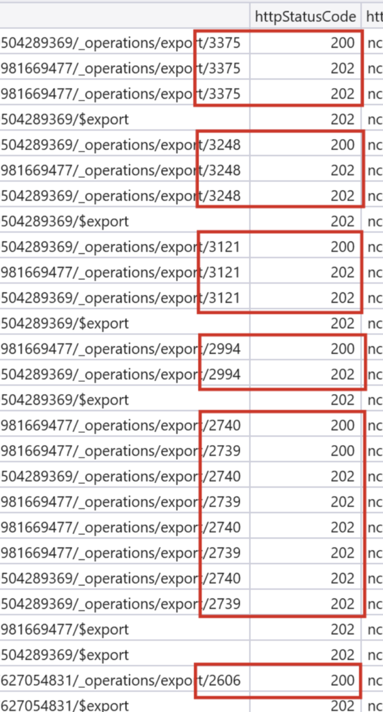

I have 4.0.264 version of FHIR server installed. <FhirUrl>/Patient/$export is NOT working.
However <FhirUrl>/$export and <FhirUrl>/Group/<groupId>/$export IS working as expected.
Any suggestions on how I can resolve this?

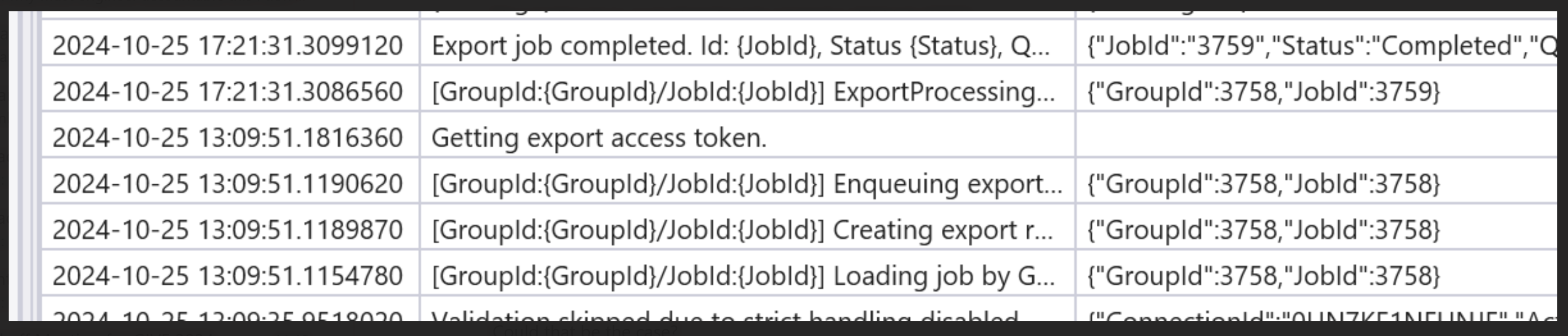

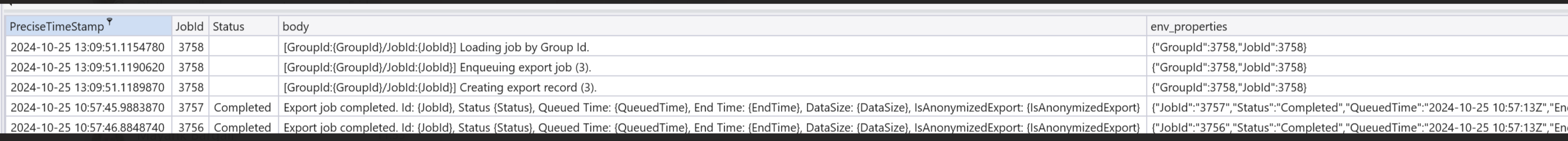

    @Lakshmi Thanks for your patience, below is the summary of the issue.
    Issue: The Patient/$export operation is returning http response code 202 with a location URL to poll; however, the polling URL continues to return http response code 202 even after waiting for a long time.
    Findings/Resolution: We have observed that it takes approximately 4.5 hours to complete a processing job. we recommended you run multiple smaller Patient exports in parallel. The patient exports are very slow, and this is a known limitation of our service. The Engineering team is aware of this issue and has plans to improve it. We do not know how long the job will take to finish, and until then, the polling endpoint will continue to return a http response code 202.
