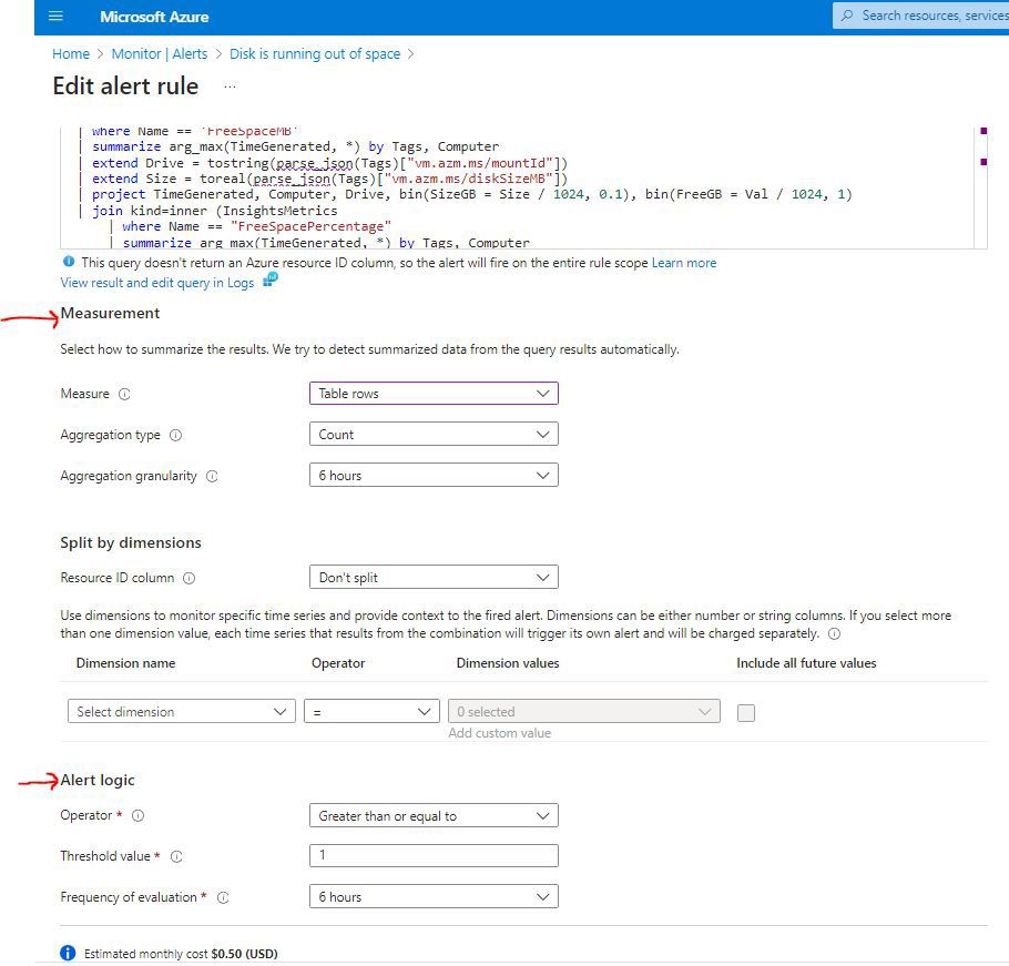

Hi, we would like some assistance to setup an Azure alert with correct "Measurement" and "Alert logic" values. We are using this query that brings us the result of all our servers with their disks free space. We would like to setup an alert using this query that should triggered when any of the disks goes below 10% of Free space. We are not sure on the correct values to be used (Such as under Measurement; Measure, Aggregation type, Aggregation granularity and under Alert logic; Operator, Threshold Value, Frequency of evaluations etc):

We are currently using these values but not getting the correct result s wondering what values do we need to select here while setting up this alert:
alert-diskspace

  1. Timmy Malmgren 1,521 Reputation points
    2024-10-24T14:00:53.1466667+00:00
    Hi
    You should check out AMBA from Microsoft that already have this exact alert in its catalog (its even at your threshold with 10%) :)
    https://azure.github.io/azure-monitor-baseline-alerts/services/Compute/virtualMachines/#data-disk-free-space-percentage
    AMBA (Azure monitor baseline alerts) is a collection of Alerts from Microsoft, you can use it as a package or check out each individual resource/alerts per resource. They give you the option both to deploy with Azure policy, arm/biceps or deploy directly into the portal.
    You can also go through other resources in the catalog to se some of Microsoft's general recommendation (ofc these are just baselines that needs to be evaluated by you).
    Hope this is helpful and remember shared knowledge is the best knowledge 😊
