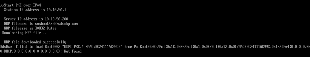

When I use PXE to deploy an operating system for the first time, the process is successful and the system is deployed correctly. However, when I attempt to redeploy the operating system on the same virtual machine via PXE, the PXE boot fails. As shown in the figure below.
ea47d1d1e5766bb1b792222636f6f20
By my test i found that if I create a new virtual machine, PXE boot works again.I discovered that if I change the MAC address of the virtual machine’s network adapter, the PXE boot works again too. So, how can this issue be resolved?

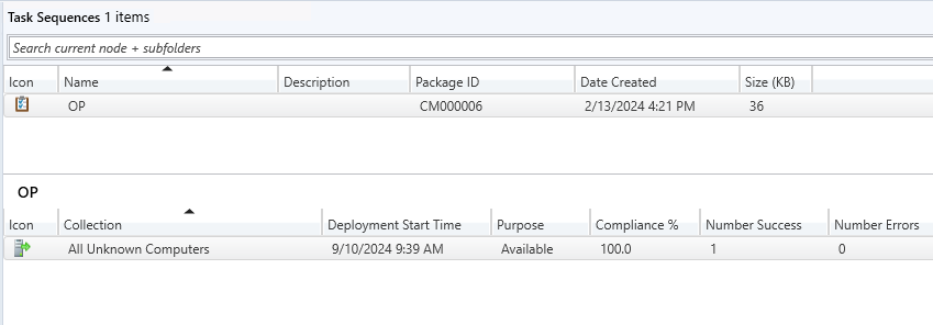

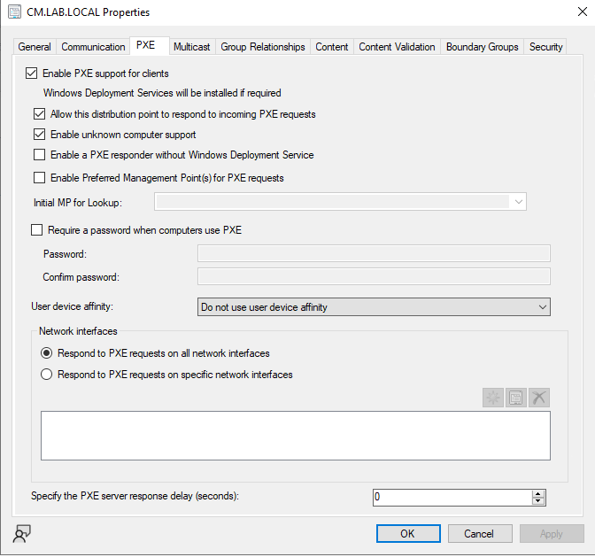

Below are some configuration screenshots from my server:

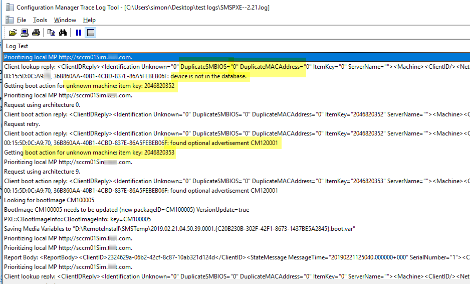

    Per my experience, this issue may be because the client is recognized as a known client and no optional advertisement for it. We can check this in the smspxe.log on the server.
    When the WDS server receives the PXE request, it (the WDS server, not the client itself) interacts the client's MAC address and SMSBIOS with the MP to see if the client is in the ConfigMgr Database. If it isn't in the database, the client will be recognized as an unknown computer. So that the WDS server decides if there is a suitable deployment and optional advertisement for the unknown\known client. Here is an example of SMSPXE.log in my lab to show the details:
    unknown computer
    When an unknown computer is started, Configuration Manager recognizes the computer as an unprovisioned computer rather than an unknown computer. This means that the computer can now receive the task sequences that were deployed to the unknown computer object. The deployed task sequence then installs an operating system image that must include the Configuration Manager client.
    Similar thread for your reference, we can also try to clear PXE flag to have a try.
