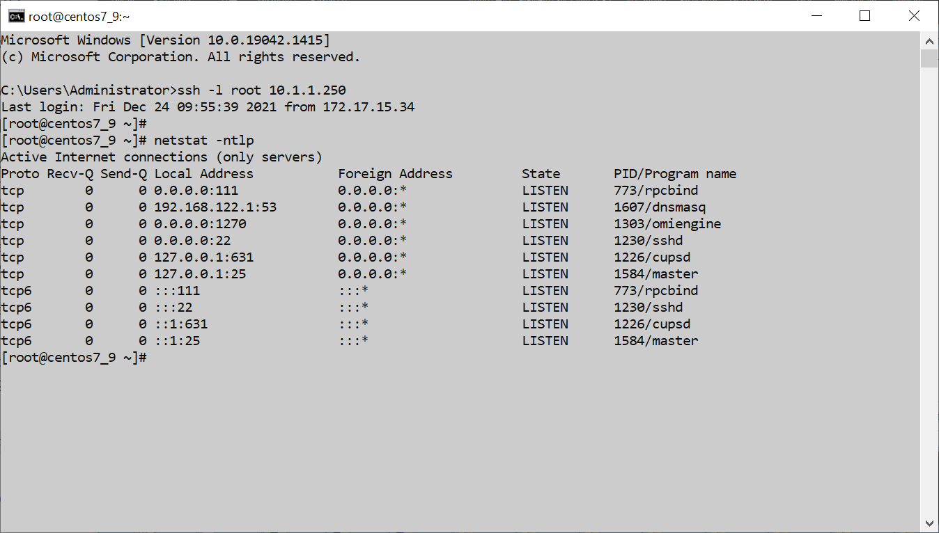

    1, in one of the ubuntu servers, use netstat -ntlp to show all the listening ports and program, and we need make sure the desired program is in it.

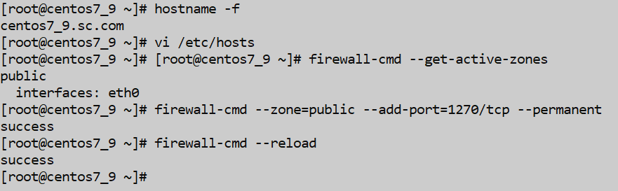

    use following command to open these ports in the firewall. If you have already done this through network manager, skip this.
    note: the command may differ among different distros of linux
    firewall-cmd --zone=public --add-port=<port>/tcp --permanent
    firewall-cmd reload

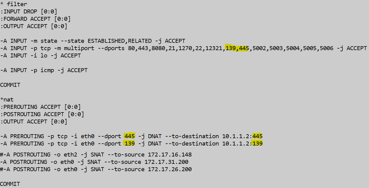

    3, if we want to access from outside of the subnet, we need to configure the port forwarding in the gateway to allow the traffic.
    note: the gateway could be windows/linux comptuer, router or something similar, either on-premises or in the cloud. Here, took a linux gateway as an example, just to illustrate how it works:
    After the port forwarding is set, test the port from outside computer to see if it works.
    image1: get listening port
    netstat_command
    image2: add firewall rule to allow the trafficscom_linux_port_1270_centos

    image4: port forwarding sample in the linux gateway via iptables
    iptables_debian7

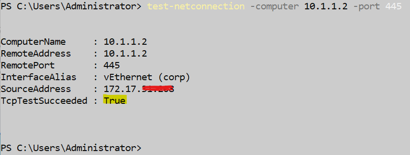

    image5: test from outside via windows powershell (the same functionality as linux nc commad)
    test_netconnection_445
