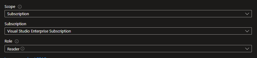

    • Grant Reader Role Managed Identity to your Logic App for your subscription:
    Switch-on System Assigned Managed identity for the logic app.
    Add Role Assignment
    Add following role assignment. Reader Role as subscription scope, and click Save

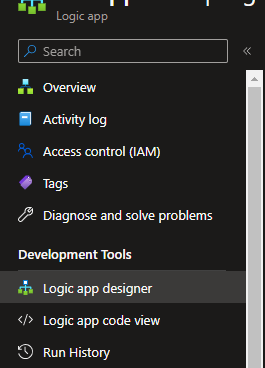

    Now Go to Azure Logic App's Designer Page.
