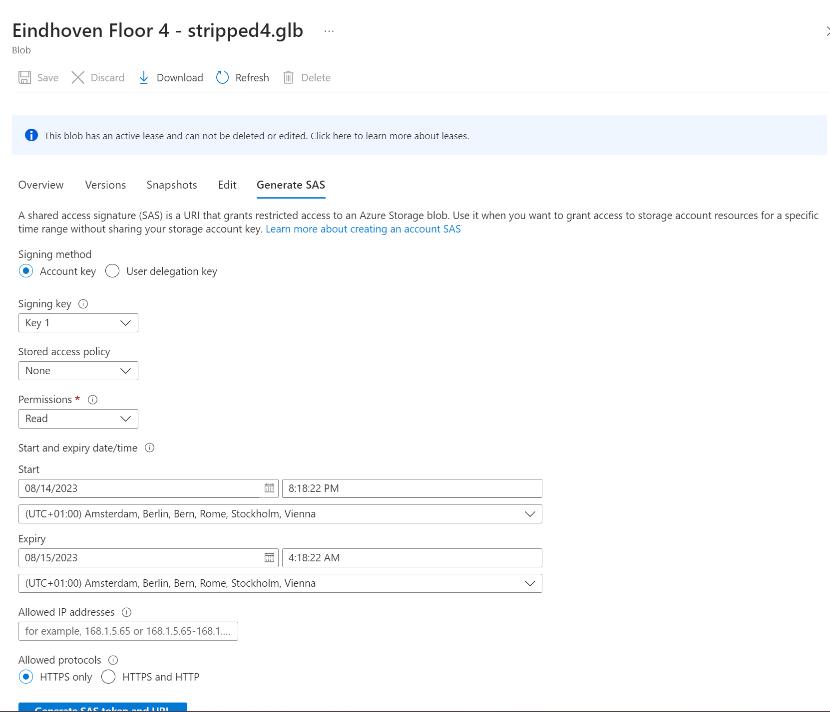

    Put the files you want to send to a device in a blob storage and send the device a desired property with the SAS token so the device can download it over HTTPS:
    SAS tokens can expire so you could set the expiration date far into the future.
    A more secure solution is when a device has no access to the file anymore (SAS is expired), It sends a custom message to the cloud requesting a new SAS. Then, some cloud logic (like an Azure Function) creates a new SAS token and updates the desired property.
    This is the most flexible way to download small or large messages in a secure way.
