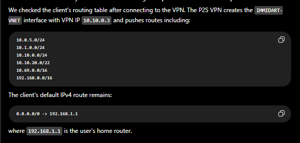

    1. New Azure VPN config downloaded from the Azure Portal VPN Gateway P2S (doesn't work)
    2. Checking of ipconfig /all , route print, tracert, nslookup, test-netconnection, telnet, wifi/wired interfaces settings (all checked, no issues)
    3. The problem is somehow related to the the Microsoft EDGE web browser DNS settings. When open Microsoft EDGE -> Settings -> search for "dns" -> look for "Use secure DNS to specify how to lookup the network address for websites". By default there is a settings set "Use current service provider". To solve the case and have the internet connection while on Azure VPN select "Choose a service provider", click in the empty field below and select e.g. "Cloudflare (1.1.1.1)". It will appear as "https://chrome.cloudflare-dns.com/dns-query". Screens attached. Then reboot the web browser - Microsoft Edge - and the internet will start to work right away.
