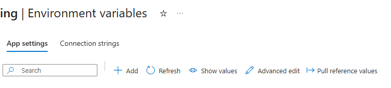

    The function might have missed the connection string parameter reference during the deployment. You can address this by navigating to the configuration section of the Azure function on the cloud portal and add the application setting. Please refer the below image for more details.
    Make sure to name your application setting parameter as EventHub and provide the same endpoint value as used in your local.settings.json file. Note that no quotes are needed when you provide the key and value for the parameters.
